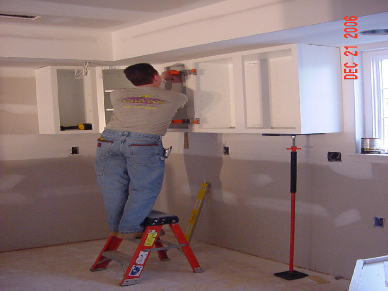

OT_Cabinet Clamps
OT_Cabinet Clamps
Cabinet Clamps.jpg (37.58 KiB) Viewed 5949 times

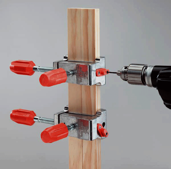

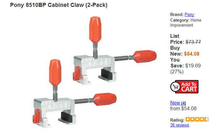

These clamps are great for aligning/clamping cabinets, better than quick-grips or parallel wood clamps 'cause they flush the faces at the same time.
There are two different sizes sold, one is better for narrow stiles.

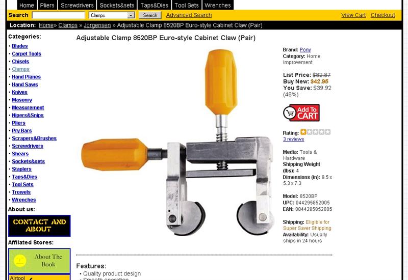

Here is the Pony clamp for Euro-style (aka frameless) cabinets.
Pony Euro-style cab clamps (Medium).jpg (61.58 KiB) Viewed 5721 times
