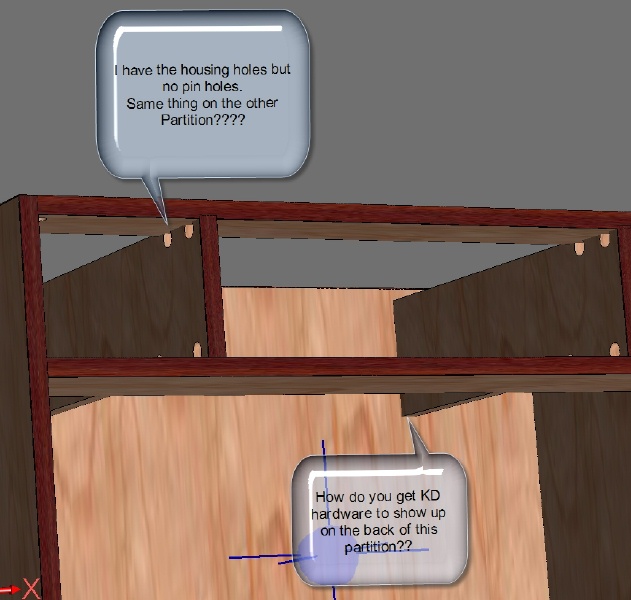

On the two partitions, I have housing holes but no holes for the pins on the two upper front housings. Also I can not seem to get the KD fasteners to show up on the rear of these partitions. I have tried different offsets but can't seem to get the magic number for them to show up.

Disregard the Pin Holes. I figured that one out. If you change the opening Height, the Partitions do not resize and therefore they get crammed up into the top stretcher causing a problem with the visibility of the holes. I would still like to know if the KD fasteners could be located on the rear of the partitions without having to manually place them in the parts editor.
Thanks.

I’ve been able to reproduce your issue it’s caused by the insets you have for the partitions KD. I have this listed for the programmers. Sorry for the inconvenience.
