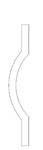

I'm guessing this is the shape you are looking for.
Counter .JPG (8.94 KiB) Viewed 8419 times
I am having problems getting this to work also. I saved a DXF file in a CAD program so I could open it in the second screen of the part editor (right click, Load Geometry). It will show up in the second screen for me but when I bring it back into the first screen of the part editor it doesn't show up. I included a zipped DXF file just in case you want to try it.

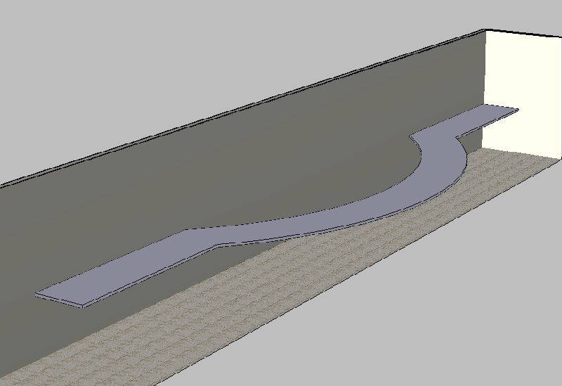

It seems to work. The LDE is struggling a bit though.
