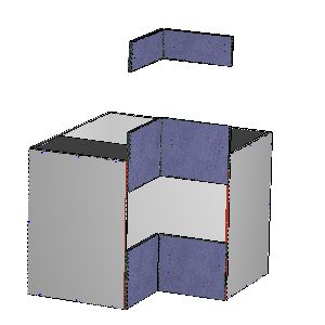

Every time i change the height of the cabinet the drawer fronts move off the cuboard. All the holes that i have constrained to the back stay in place and the heights of the drawer fronts change accordinly. Does anyone know why this is happening?? Any help will be muchly appreciated.
I have attached the Jpeg and hsf files with the problem.

That looks like a problem that used to occur on regular (non-corner) cabinets but was fixed. It might not have been fixed for the corner cabinets.

Does anyone know if this issue is going to be fixed anytime soon??

When you need something fixed quickly it is best to use the Feedback in eCabinets to report the problem.
Open eCabinets, click on Communications then choose Feedback. Fill out the form to describe the problem, attach your cabinet and check the box at the bottom of the form that says 'Contact me as soon as possible".
This sends your problem directly to the programmers.
Are you using Version 5.2 Build 4?

Yeah i have update to Build 5, i will make sure to report the problem
