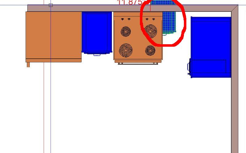

I am having problems when I try to move a cabinet a little bit closer or further from the other. For example, I had a blind corner, when I place my other cabinet, there is a 2" gap between them. I adjust my move increment to 1/2". But when I try to move one of them, it goes everywhere but where I wanted. Could any one help explain what is happening?

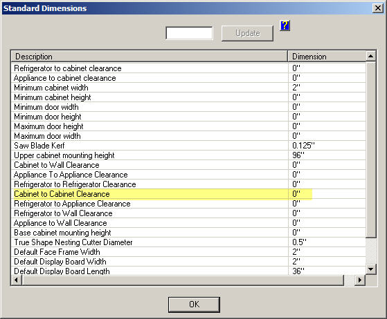

try to go to Define Standard Dimesions and change your setting there. After you do that, try to place your cabinet in the desired position.
Nemanja
Re: Moving cabinets
Nemanja Vujkovic wrote:Sergio,
Nemanja
Settings/Preferences -> Define Standard Definitions.
Look for Cabinet to Cabinet Clearance:
Std Defs.jpg (61.48 KiB) Viewed 8603 times

I appreciated your reply. However, I have done that. Even then, when I place the cabinet beside the blind corner, there is a little gap there. Then, again, I fix my object move increment, hold sift down and click my arrow. And that is what happens... unfortunately.

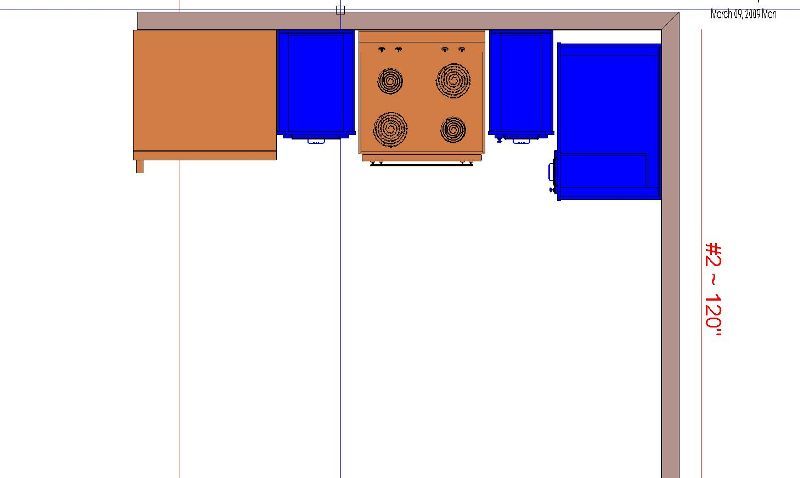

I'm assuming that the second jpg is a photo of the initial installation of the cabinet and it left a gap between the stove and the blind corner cabinet.
Have you tried going to the elevation view and changing the position of the cabinet from there. I don't have your cabinets, but I would think that if the blind corner cabinet is 24" deep you would just move the other cabinet to 24" from the rightside and it should not jump elsewhere, especially if you are in "free style" placement mode.
