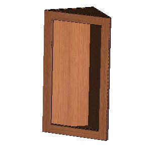

Hello,
I am a new user to ecabinets and I need to create an Face frame angled base and angled upper. Can anyone help me with that. I thank you for your time.
Mark

Hey Mark, is something like what your looking for?
angled upper.jpg (10.09 KiB) Viewed 4370 times

Close, but not exactly. I need the upper to have 12" total depth sides and the base to have 24" deep sides. These are to go into a kitchen design. I have an old DOS version of cabinetvision I have used for years and am just getting into the new millenia. I appreciate any help
Re: Angled base and upper
If you download this cab you will see how it is constructed. It is an assembly of two cabs. The faceframe is a cab with all the parts unchecked, then rotated. Note the inset on the left end, and the settings on the angled parts. The base cab can be done the same way. HTH

Mark,
Open your standard corner cabinet (base of upper) in the cabinet editor.
Click on Construction Settings
Click on the Corner Settings tab (upper left hand corner of the dialog box)
Choose Angle Front,
You will now have an angle front cabinet.
