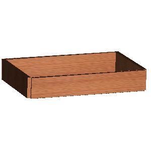

Some guy already built the toe kicks for a group of cabinets. So the toe is actually installed on the floor. BUT, the construction is in such a way that replicating it in eCabinets is proving very difficult.
I have attached a drawing of it so you can see basically what it is supposed to look like. I manipulated the program to get it close so you'll have an idea. The joint construction of the boxes is different than the software's toe. So I tried to adjust it but I could only get the BACK to change the construction joint. I could not get the front to work and that's where things matter. SO, I adjusted the back and then rotated it around. It actually works okay and I have them sized pretty close, but I CAN NOT move them around!!!! Every time I shift them in the room to try to get them perfect, they suddenly fly off to another part of the room!!
I think the real problem is the fact that I rotated them around and now have the front as the back and the back as the front and that's screwing things up.
If you have a chance, take a look and let me know what you think I should do.
Thanks fellas.
Adam

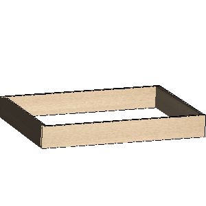

Here is a new toe.
The front of the toe is actually a stretcher. I now have that stretcher set 3/4" forward, but now I need it to extend beyond the sides by 3" on either side.
I don't see a way to get the stretcher to "stretch".
Is there a way to do this or am I going about this all wrong and there just a better way?

Re: Nightmare in the Trophy Room! HELP!!!!
Adam,
With the way you have them built you will have to place them manually using Free Style Placement. If you try to use Align to Back they will jump around.
You can create this toe by using the standard detached toe and negative insets.
Then it will place properly.
Here is the toe cabinet.
Detached Toe.hsf
(104.02 KiB) Downloaded 386 times
I forgot to tell you I replaced the stretcher on the front with a toe.
You can use the stretcher but in my opinion it is more difficult.
The only problem using the toe is that if you change the height of the cabinet you also have to change the toe.
Here is one that I use,I think it's similar to what Kerry is explaining.
TK.hsf
(114.02 KiB) Downloaded 366 times
