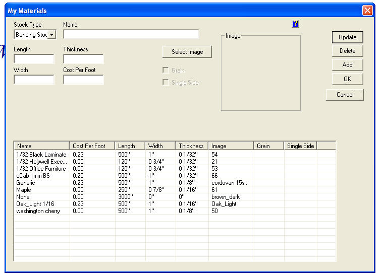

Adam,
Mouse over one of your doors and make sure you have the Conestoga Flush Batten (I don't think it has edgebanding that would show up) it sounds like you have a slab door.
If you are using Slab Doors and don't want banding you will have to create a banding material named None that has a 0 thickness and 0 width and 0 cost then choose this banding when you create your door.
Whatever door and banding that was used in your Seed Cabinets will be the default until you change it.
You can also create an MDF door using the material of your choice with no profile cuts to create a slab door with no banding.

Re: Edge Bandets!
Hi Kerry
I just tryed to set up edgebanding with None I can not get it to work it asks for all the sizes :?:
Can you help me :cry:

Rick Deskins
Re: Edge Bandets!
George,
Be sure and enter a value of 0 for cost, width and thickness
You have to enter a length
You have to select a texture image (use one that matches your material if you don't want the banding to show.
Re: Edge Bandets!
Thank You Kerry
I put it all in and pushed (Done) would not work for me 3-time :cry:
So I tryed update and it worked for me.
