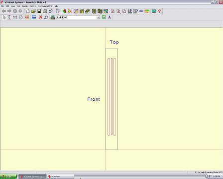

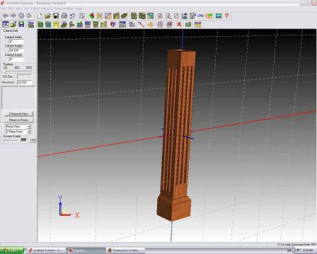

I'm attempting to add some constraints to a fluted post made from a cabinet.

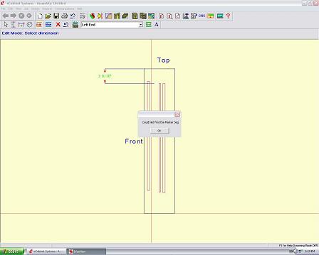

When trying to add the contraints on the left end flutes I get the Error " cannot find the marker seg" And the part gets distorted.
I've attached some images of the part in question.

Re: Constraint manager Error
That cabinet sure acted strangely. I took the back into Contour Mode of the Part Editor and Created Edges. I removed the outlines, leaving only the flutes then saved the geometry. Then I removed the cuts from the left end, took it into Contour Mode, loaded the saved geometry and returned to Part Editor and created the flutes. I wasn't sure what depth you used but I made them 1/4" deep.
I too the left end into the Constraint Manager and was able to apply constraints.
Not sure what the problem was but removing the cuts and reapplying them worked.
