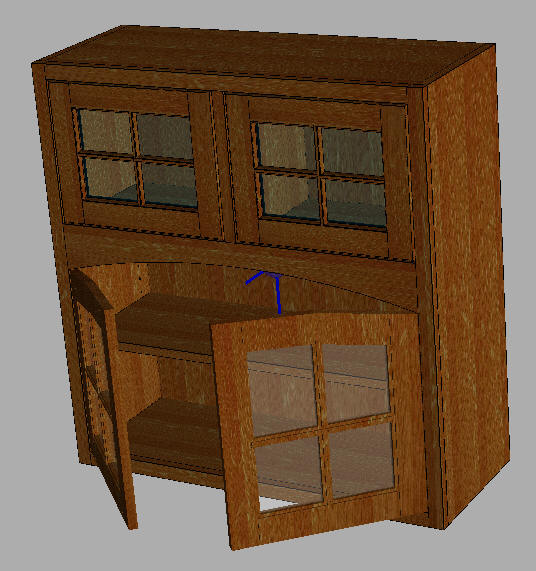

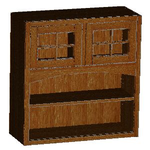

I am looking for suggestions on a way to create a pair of doors to fit this arched opening. Doors are inset and need to be 5 piece, but can be for display only.

Vince you will only be able to do this by taking a display panel into the Part Editor and creating the arched panel there.

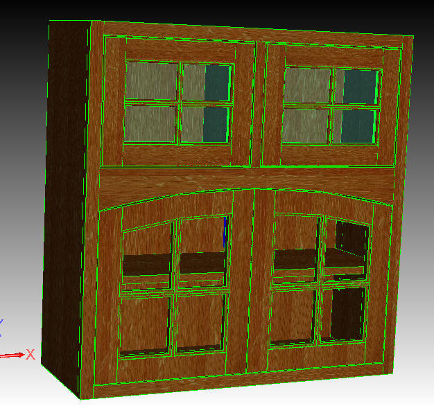

Hi Vince
WFF_Arch_Open.zip
(486.18 KiB) Downloaded 696 times

1-right door.hsf
(12.02 KiB) Downloaded 707 times
1-left door.hsf
(12.02 KiB) Downloaded 706 times
Doors Open.jpg (56.52 KiB) Viewed 9355 times
