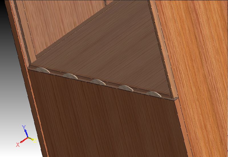

I have a tall cabinet which has sides that are 103" tall. How do I make this into two pieces without making it two cabinets? If I can make two pieces then I can corrigate them together from the outside. They are unfinished sides. Is there a way to do this? I am making the cabinet with blind dados and having them cut on a Thermwood CNC. I am afraid that if I make the side short and add a display panel that it would affect the blind dados. What say you experts?

Where I work we make the side in two pieces and glue them together and we use corrigated staples (in picture) to hold it together. It makes it much easier this way. I am just trying to avoid making two cabinets. I may not be able to avoid it.

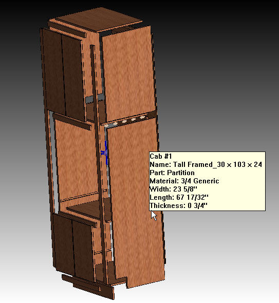

We do this also when 120" material is not available. We either preglue up the desired length or trim the ends for a tight joint and butt both pieces on the router. Create the longer material in ecabs and change those parts to the longer material.

Look at my tall cab 30 x 103 x 24
If you tilled it from the front with a 5"toe kick the ceiling needs to be 105" that will give you a 1/8" to play with :lol:
Here is the cabinet it is all one tall cabinet
The sides are partitions
Tall Framed_30 x 103 x 24.zip
(333.65 KiB) Downloaded 710 times

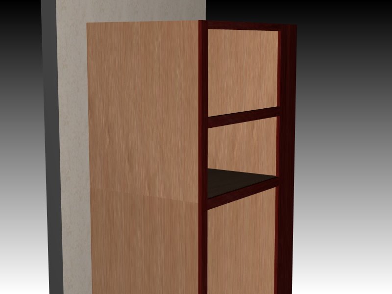

Ok'!, Ok!, I have to admit, making two cabinets is not as bad as I thought. :oops: It does seem to be better. Thanks guys for giving me room to grow in my abilities and understanding. Thanks for the advice. :D
