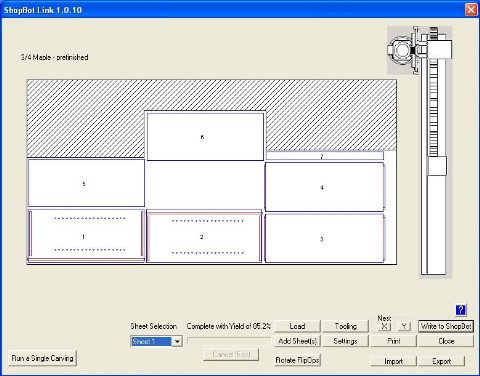

I'm a little perplexed by a nesting layout (see below) that ShopBot Link did with a simple test cabinet I've been working with. I was wondering why it did not move part 6 between part 5 and 4 and save a bunch of plywood. If there is a problem in getting it to fit, it seems like it could have moved part 3 and 4 further down the plywood to allow 6 to fit. I used a Y nest for this as I like having long off-falls versus short off-falls.
Is there something in the nesting algorithm that is not handling this situation correctly?

Weird nesting from SBL Medium Web view.jpg (53.5 KiB) Viewed 31166 times

Hi Don. Did you try nesting in both X and Y? The nesting algorithm provides ample scope for a human being to establish his supremacy over a computer program. Manual nesting could yield better results for very small orders. However, for a reasonably big job, containing a good mix of big and small parts, it may be difficult to beat.

I kinda figured that with a small number of parts the software might not be as efficient, but in this case it confused me a little as to why it lined up everything except that one part (6) and just kinda put it randomly out into la-la land when there was plenty of room to put it in line like it did with panels 1, 2 and 3.

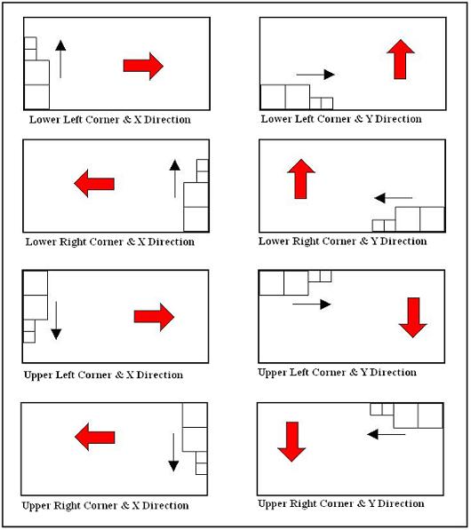

This result is due the direction that the sheet gets filled. I'm guessing you selected Y direction. This results in Part 4, in your case, getting stuck at the odd location because it can get lower. I have found that this slight fit is due to the True Shape nesting. We do have an option for Cut Line nesting that doesn't try to do this type of fit. I will turn it on in the next version.
The sheet filling starts at the Nesting Corner. Nesting Corner is the corner on the sheet from where the nesting process begins. ShopBot Link allows nesting from four corners: Lower Left, Lower Right, Upper Left, and Upper Right.
Nesting Direction is the direction in which the sheet gets filled (and not in which the parts get nested). Nesting can be done either in X direction or Y direction.
If the nesting direction is X, then parts will get nested along Y and if the nesting direction is Y, then parts will get nested along X.
The following figure illustrates how the nesting pattern differs upon the combination of nesting corner and nesting direction.
Here is an illustration for the nesting process.

Nesting Direction Description.JPG (40.2 KiB) Viewed 31070 times

One more note on this. I did get your files to reproduce this nest. It does only occur in the Y Direction nest. It also appears that if I implement the Cut Line nesting option you get better results. It will be available in the next update.

I'm going to try playing with the X and Y settings along with the starting corner settings to see what happens. I had gone back and forth between the X and Y setting but didn't change the corner origin. When changing between X and Y layout, I found that the Y layout was no better and still put one of the parts out into la la land even though there was room for it tucked in with the other parts. I'll let you know if playing with the corner origin makes any difference.

You shouldn't need to change the Nesting Corner to get a good result. When I clicked the X Nesting button I got a good result. See image..
