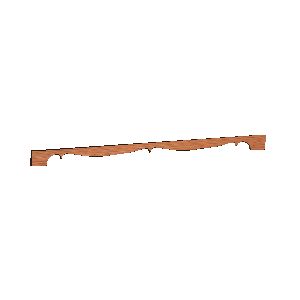

I have used auto cad 2002 to create a shape to use on a box base. I saved it as a DXF file and then created a display board and took it to the part editor. From there I took it to the contour editor and imported the file and applied it to the part. When I try and used to lines created to cut a closed contour the software tells me the it is not a closed contour. I used the extend function and extended the lines past the ends of the other lines. It looks closed to me but the computer does not believe me. :wall: :wall: :wall:

I was trying to make a base molding that is 48"long,3 inches tall and .75 inch thick with a rabbit on the back side. It is to be applied to the base of a blanket Chest.

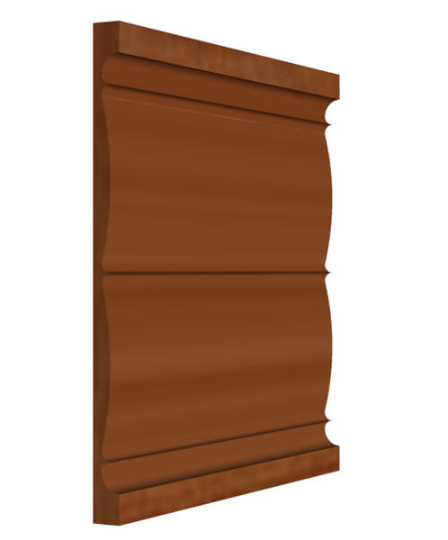

Re: DXF importing
Oops! Got yer dimensions a bit off then. :joker:
Make the DXF 3 inches tall, 3/4 inch thick and include the rabbet. Then, with a Display Cube .76" wide, 3.01" long and 48" deep, apply the DXF. Back in Part Editor, select the contour and "Create Part Using Closed Contour."
All of this is, of course, assuming you only want the part for display purposes. If you want to machine the part on a CNC then you will have to use a Display Panel (from sheet stock) of the correct dimensions and create a tool from the DXF. The tool would then be used to profile the edge of the Display Panel.
One thing I noticed that might be where your problem came from. If you hover over the back (flat) side of the shape, it is actually two 24" lines. It looks like you took half the shape and mirrored it. When doing this I have found it is best to delete one of the straight lines and extend the other past the intersecting line and trim it.

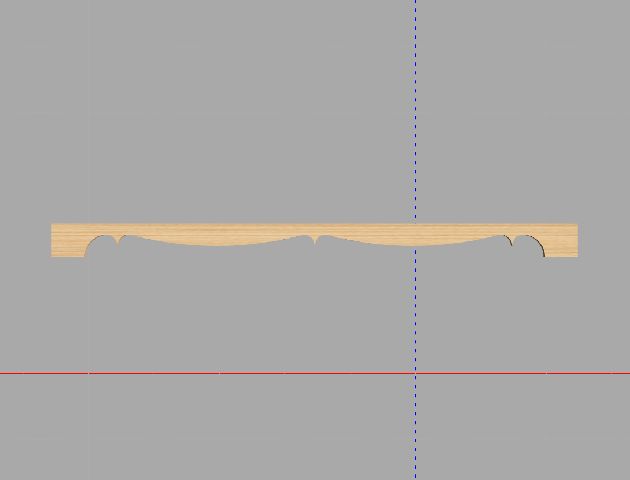

Still having problems with "Closed Contour" I tried using the zipped file and the one I created but when I right click on the contour I get the message that this does not seem to be a closed contour. I am sure I am missing a small step but having trouble finding that step. :wall:

Seems as thought I created the DXF file and it was not at the 0,0 in the autoCad software, so when I opened it in the manager I had to move it to get it on the part correctly. Evidently when I was moving it, it was opening up the contour somewhere. I found this when I just clicked on the created contour and the software allowed me to cut the shape, but it was not on the part. I moved it and the contour opened up. I went back and reworked the DXF file in autoCad and re imported it and HOORAA it now works!!!!!!!!!!!! :joker: :beer: :mrgreen: :D
