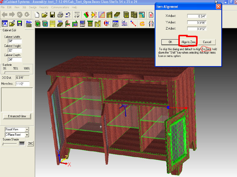

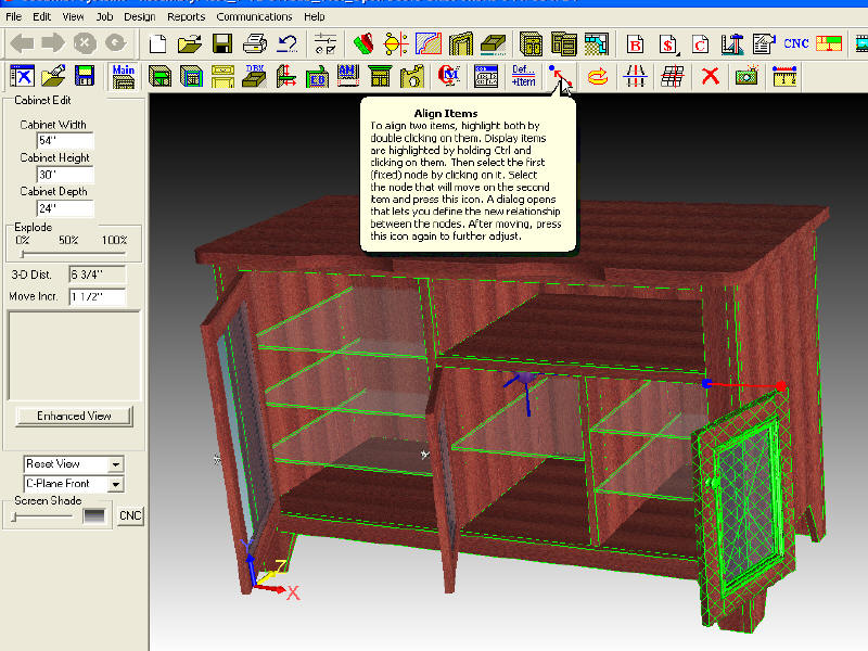

Hi we have made sets of doors with cabinet backs that can not be made in the door drawer front designer, how do you attach them to cabinets for display in the custom layout :?

You have to apply the doors manually in the cabinet editor.
Re: Attach cabinet back doors
Like Gary said I would put them on the cab in the cabinet editor

George/Gary thanks i`ll give it ago.
