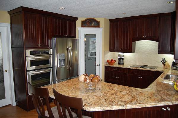

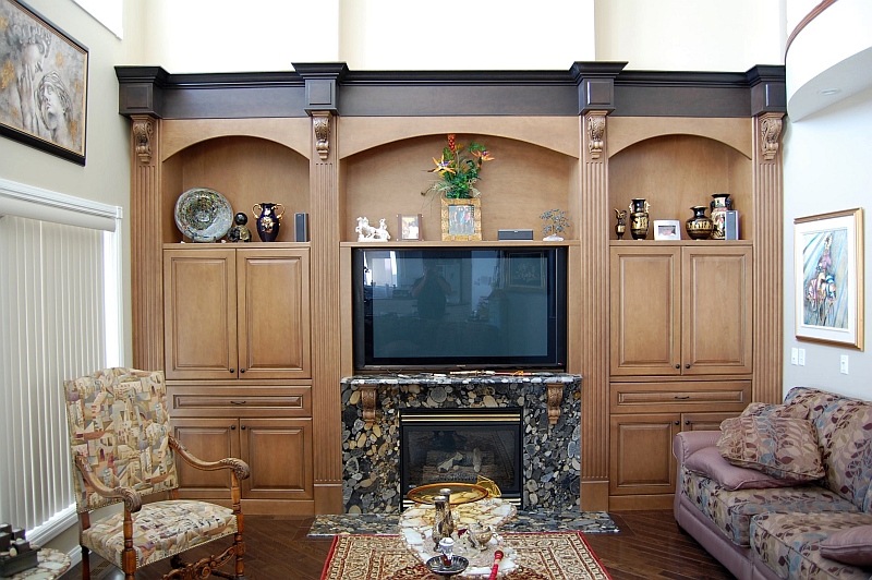

If anyone want's a real simple way to colour Maple or Cherry or anything that blotches just use a spray stain from MLC called Windsong 2. You can make it as dark or as light as you want without blotching and once sealed with anything ( lacquer ) it can be Glazed or accented as you wish. It is quite easy as you build up your coats lightly until colour is a achieved and they will match any colour you want. I use it all the time and everyone loves the results. Heres a couple different ones done with it.
