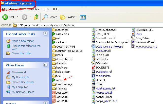

You can create new folders inside the eCabinets/Import directory to organize your files. All folders must stay in the eCabinets/Import folder for eCabinets to find them. You can't have subfolders inside the folders you create though.

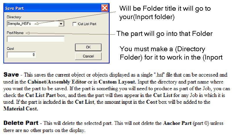

OK, I had a thought and tried it out. You need to go to the Display Part Editor, bring the part in and save it in a directory that you name. I guess after you name the directory you can just transfer the files over to it.

I am able to create new folders in explorer. Using the display part editor to create the folders is probably best. Remember that you must have your .hsf file and a .jpg file (300X300)with the same file name to be able to select the object such as glass.hsf and glass.jpg (If you don't have the .jpg then you won't see your object in eCabinets)

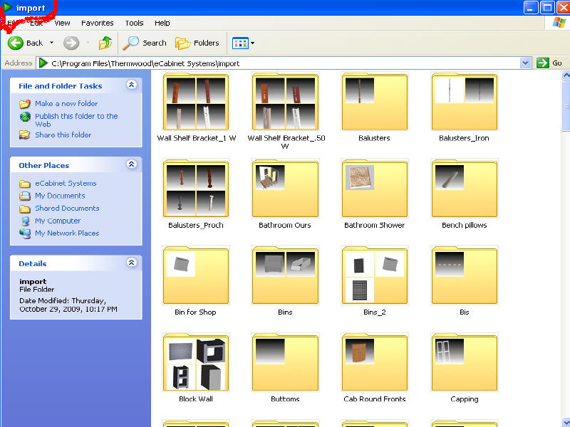

What I was thinking David wanted to do is just organize objects he already had in the import folder. If you create new folders and move both the .hsf and .jpg files you can arrange them any way you want using explorer.

This my eases way
