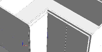

I am trying to create a 3 Door 90 degree corner cabinet similar to the following picture. When I add the left hand door and incorporate a Right Hand Reveal everything works as it ought.
However when I add the double doors to the right hand face of the cabinet, the picture indicates the result. The result shown is NOT what I require. I require that the pair of door on the right hand face have a 20mm left reveal so as to create a bifold type door.
This is the sort of what is required
corner door issue.jpg (11.02 KiB) Viewed 2060 times

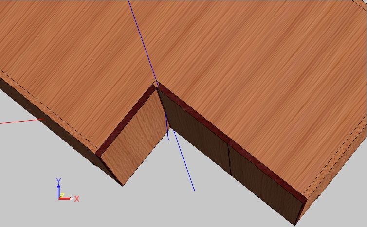

The problem is that when I incorporate a left reveal, the software incorporates the left hand reveal onto the RIGHT hand side of the doors (see the second picture). This is obviously some sort of bug. Is there any possibility of this being addressed for version 6 release?

By adding a left reveal, eCabinets displays a RH reveal instead
CNR door with 20mm LH Reveal.jpg (11.12 KiB) Viewed 2060 times
Re: 90 Degree Corner Cabinet - Right Reveal
Renato, Hilite the left opening first and add a left hinge door. Then hilite the other opening and add double doors. Then hilite the left double door and right click>Construction Settings, then add your Reveal to the hinge side, and OK. That should work for you.
