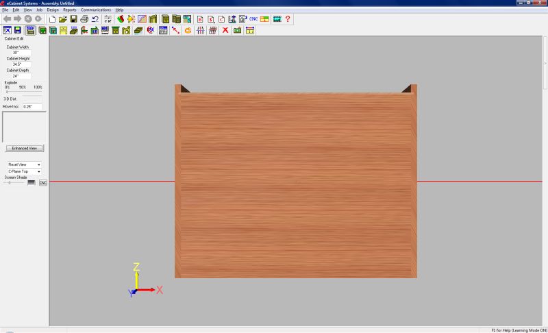

Thanks Daniel.
I don't understand why the part would be cut to a depth of .749 I would only want it the same depth as the other dado's. Also I have LOTS of cabinets to do this to. How do you place the box to line it up and give it size parameters manually? And when I resize the cabinet will that mess things up? This seems like quite a bit of trouble just to have the bit hang off of the edge of a part.

Ok Daniel, I'm starting to catch on. I was trying to make the dado/rabbet and let the bit cut off the edge a bit, but I see what you mean now. Oversize and trim the part. I did the design on my test cabient and it works. The constraint is kind of bugging me. I resized the cabinet and it seemed to stay with it in cabinet assembly edit area. When I send it to batch for cutting and resize it will those cuts stay with the cabinet ? I've never used the constraints and don't know if it matters for this type of cut. I guess it may leave a little fuzz on the edge of the part, but it shouldn't be to bad.

It looks like 2 simple constraints on the cut to keep it set at .05 in width and at height will work fine for resizing the cabinet. I added these to the left side of the sample cabinet I posted and it resized fine.
