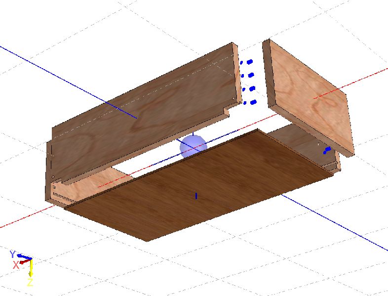

I know you used to be able to drill holes in the sides of the drawers using a positive value for the hole. I looking in the help section and it's changed since I last looked at it and doesn't say you can do this, but I guess it's worth a try. I worked around this issue by designing my standard drawer box as a cabinet. That way I can add in holes for drawer front adjusters, and notch the backs for tandem slides, ect. I also drill locator holes like you are talking about for the ball bearing slides. What I do is I use a 1/16" drill bit and do it as a thru cut so I don't have to do a flip op. Then I just use a dab of white caulk to fill the hole and no one ever knows it's there. If you don't want to do that you can program it so it will be a flip op if you design it as a cabinet.[attachment=0]dwr 2.jpg[/attachment]
