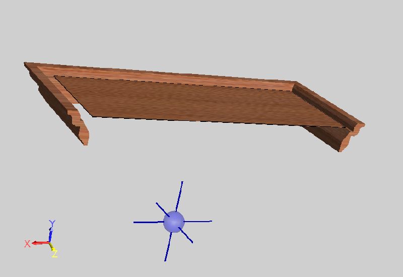

The cabinet with the crown on it now copy and paste.Now you have two of the same cabinet
Now delete everything but the crown on the one cabinet all you will see is just crown it is still a cabinet and you can resize the crown.I keep the top on that cabinet i will make it 1/16" T. That way I can lock it to the other cabinet
Top crown.jpg (25.37 KiB) Viewed 4587 times
