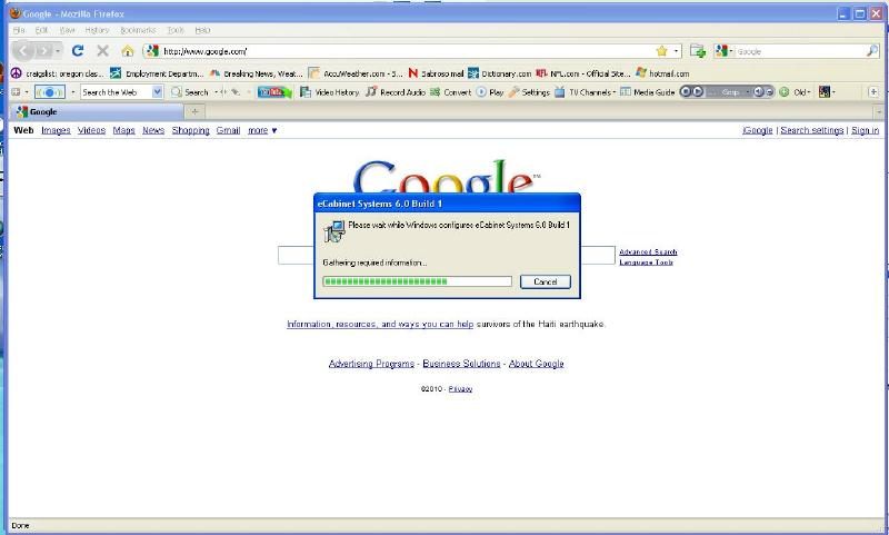

Larry, I have attached a snapshot of what it looks like when it happens. It has been random at times, but lately I have noticed that it is happening everytime I open an internet browser. Firefox or IE, doesn't matter. When the browser is not running at all, and I just go click on the icon to run the application, immediately after the browser comes up, the Ecabs reloading message appears.

According to what you are saying, maybe the browser application is affecting a file for the eCabinet installer. Hopefully by looking in the Event Viewer we can find the problem. To get to the Event Viewer go to Control Panel -> Administrative Tools -> Event Viewer. Click on Applications and open the events that occurred when the installer popped up. Then post what you find for each event.

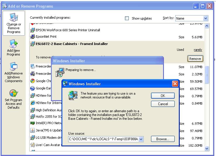

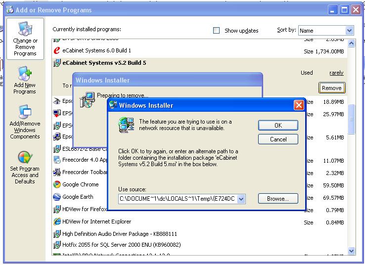

I have also taken a couple snapshots of my add/remove programs window, and it's problems. I have v5.2 still listed, even though I have uninstalled it. If I try to uninstall, it comes up with the error shown in Clip2.jpg. I also had previously installed ESL6872-2 Base Cabinets add-on (under v5.2), and uninstalled it. It also still shows up in add/remove programs, and gives the error shown in Clip3.jpg when I try to uninstall again. I also use a computer maintenance product called Ccleaner... it can uninstall programs also, and remove their entries in the program list. When I click on "Delete Entry", it says "Cannot delete MSI Installer".
There is definitely something going on with the installers of these programs. What I would really like to do is have some way of wiping any record of Thermwood products from my machine, and starting over with a fresh clean install of v6. Short of reloading Windows and all other applications, I don't know what else to try.

The way to remove these particular installs is to run the install again and select the Remove option. If you no longer have the exe for these you can download them from the following locations.
For the library installs:
http://www.ecabinetsystems.com/ecabinet ... raries.htm
For the 5.2 Build 5 install
http://order.ecabinetsystems.com/update ... Build5.asp

From the information you have posted it appears that there is an add-on in your browser(s) that is conflicting with a module that is used by eCabinets Systems. If you don't mind we would greatly appreciated if you tried removing add-ons in your browser(s) until the problem does not occur any longer. Then let us know which one was the culprit so that we may reproduce the problem here and find a resolution with our installer.
