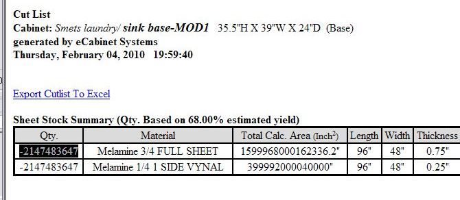

Ok all done with my job and go to get my cut list and find out how much material I need to go get and I get -2147483647 sheets of melamine. Whats going on? I narrowed it down to one cabinet that was making it happen. anyone ever gotten this before? How do I fix this? Here is a screen shot of the cut list. And its crazy that the 1/4" back panel is giving my the same "Qty." number but its a diff "total calc. area"

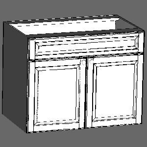

Here is the cabinet if any one wants to check it out to see if you come up with the same results.

Re: Strange numbers in cut list. Please help
Ben,
It looks like something got corrupted in the cabinet file. Open the cabinet in the cab editor, right click and choose to Remove Part Editor Cuts from the entire cabinet. This will regenerate the cabinet and that seemed to fix the cut list. I didn't see any part editor cuts on the cabinet but if there were you will have to re-do them.
