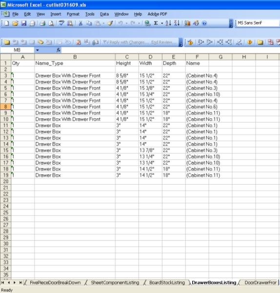

Ben,
Export your cut list to Excel and click on the Drawer Boxes Listing tab and you will get the size listing that you want.
I have used a macro to clean up the file names and sort the list but the point is you can get your outsourced drawer box sizes here.
Gary Campbell

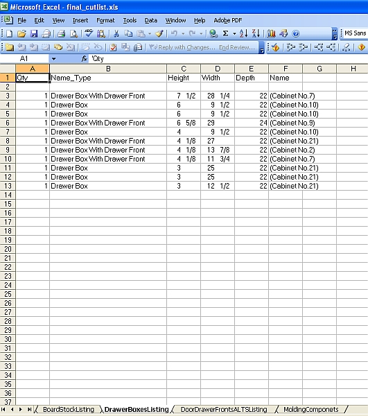

Don, Tim,
Export your cutlist to Excel and that information is under the Drawer Boxes Listing tab.
Posts: 846
Location: Newport, WA
Re: Drawer Box Pains... Suggestion
Post by Donald Thomson »
Thanks Kerry,
This is exactly what I do already. I've got a spreadsheet that I can plug these numbers in to and it will give me an estimate for each drawer box. I do the same thing with doors and drawer faces. I just use the latest sq. ft. pricing from my vendor and viola, accurate estimate.
