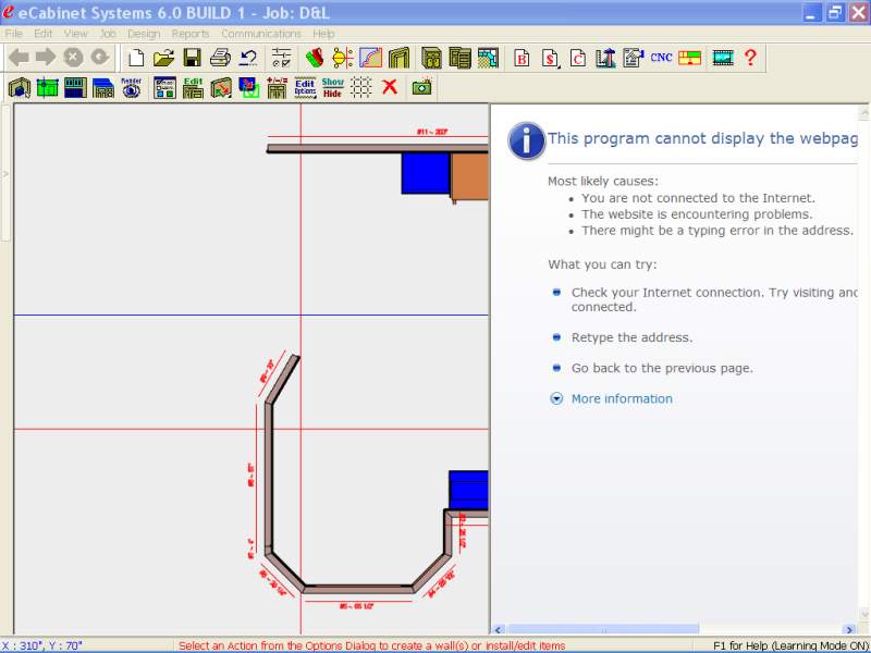

Post by Wally Schneeberger »
I tried build 2 and it was to much of a problem so I restored to an earlier time and now I can't run my job -- Here is what shows on the right side and I am connected to the internet.

I suspect this has to do with some HTML files that were updated during the install. Did you attempt to uninstall Build2 then rerun the Build1 installer?

I am not for sure if restoring windows restore point correctly restores ecabinets. If you have your mind set on running Build1, then you need to rerun the Build1 setup and do a repair. I encourge you to redownload Build2 (Setup1b) and and give build2 another try. For having a lot of problems with build 2, I only seen you post about 1 problem. Please post the other problems (with steps to reproduce the bug) that you are having so we can get any possible bugs fixed.
