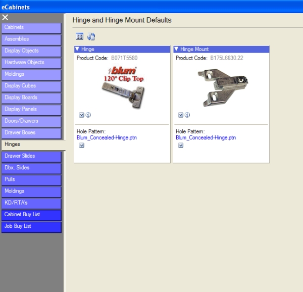

I have a question. I noted in Kerry's earlier post that his inline image showed a hinge and the associated hole pattern on the left and the hinge mount with it's associated hole pattern on the right. I noticed that both of the patterns are exectly the same.
Now I have NOT tried this, it is purely a theory and a question. With so many complaints about speed etc would it not be more appropriate to apply a pattern to the hinge which purely drills holes into the back of the door, then apply a DIFFERENT pattern to drill only the mount holes into the carcase (or alternately and probably more likely, simply apply 1 pattern only which drills both the door for the hinge cup etc and the carcase for the mount, then leave the mount pattern blank).
The logical side of me sees that if you apply the same pattern to both the hinge and the mount, then this would be asking the program to try to apply the same pattern twice, ie twice the work. I'd be pretty sure that the eCabinets code doesn't check to see if they are the same pattern and then jump to the next part of the program. I would assume instead that the code would simply process one pattern after the other, and in the case where then same pattern is applied to both the hinge and the mount, then this is simply telling eCabinets to do the same thing twice. I don't imagine this would not be a good thing at any time, yet alone where the program is experiencing speed issues in the first place.
Now this is only a hunch due to the fact that I have seen measurable performace gains by using a library without any operations on any of the cabinets versus the identical library chock full of operations.
Could Kerry or Ryan please confirm or deny this theory.
Sean
