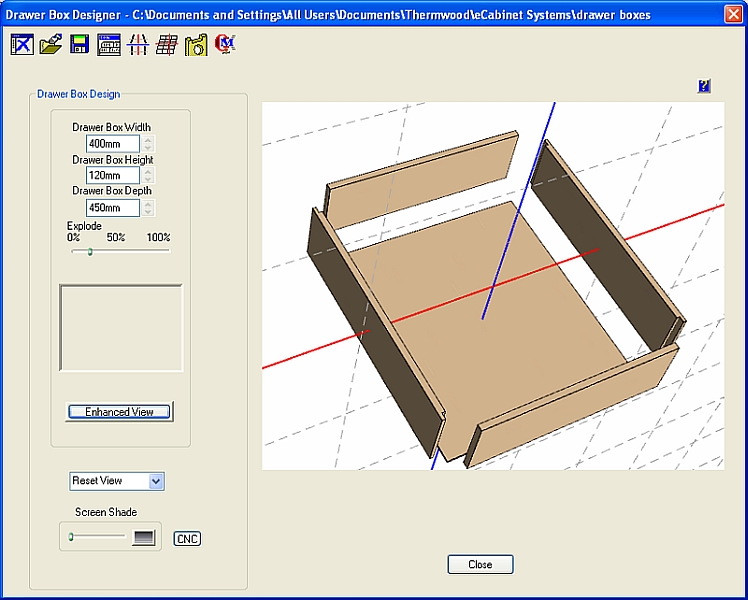

changing materials on one cab from 19mm veneer to 18mm painted mdf (both in my sheet stock)ecabs told me I couldn't I had to use same thickness. with my arrow pointer flickering all around the screen i managed to create a new drawer,this had to have 12mm rebates on each end of the drawer sides. I have struggled to this with a 13mm cutter. (tool comp) so I decided to make my own 24mm cutter. When I tried to use this ecabs told me it was closing down tool manager. Also when I tried to apply the constraints to the rebates ecabs told me I couldn't put dimensions between the nodes selected.

This is the drawer I have a problem with. I made the three 12mm x 8mm rebates in the drawer sides
with a 13 mm straight cutter i had created months ago. I found the tool comp a bit confusing so
decided to create a 24 mm dia cutter to avoid the tool comp problem. I had no problem
creating the tool, and it saved with all my others. When i selected the tool to cut the rebate
a dialog box came up stating " closing tool selection dialog". dont know what causes this.Also
i took the R/H drawer side with the 2 rebates to the constraints manager, I could'nt see the
rebates in the elevation but clicked on the 2 nodes on one end of the drawer side to add a
dimension. An error came up saying "dimensions between selected nodes not allowed. This
drawer is not yet a part of a cabinet i was just creating it in the drawer box designer.
Hope this info helps.
John.

I think this is something close to what you are wanting to do and doesn't require any part editor cuts or constraints.
rebated mdf Drawer_edit.hsf
(176.02 KiB) Downloaded 1192 times

Yes thats it Kerry, I worked out how to do it last night, as you sugested i did it with consruction settings.
Again, thanks for your help on this one.
