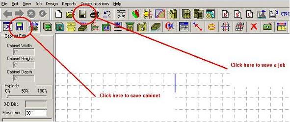

I recently updated to ecab6.3 and began using it. I can't retrieve cabinets I just created & saved. They appear in the Ecabs folder-not in a subfolder- w/a red/blue arrow icon. When I click on them, they seem to be loading, but then the screen goes to the "What would you like to do" page instead. The same thing happens when I try to open jobs I saved before loading Ecab6.3. Also, when I scroll over the arrow icons in the ecabinets folder w/o clicking on them, they all say the Job File is 12KB. The only exception is a wall layout I saved, which does come up when I click on it. ????

If it is supposed to be the cabinet, you may have saved it by using the wrong icon. The icon for saving the cabinet is the blue diskette. Don't use the diskette on the first task bar or the File>Save Job options.

Thanks Rick-- I did find my recent saves, using the tab off to the right in the Main work area. Now, any clue where cabinets I saved prior to the Ecabs 6.3 upgrade might be???
