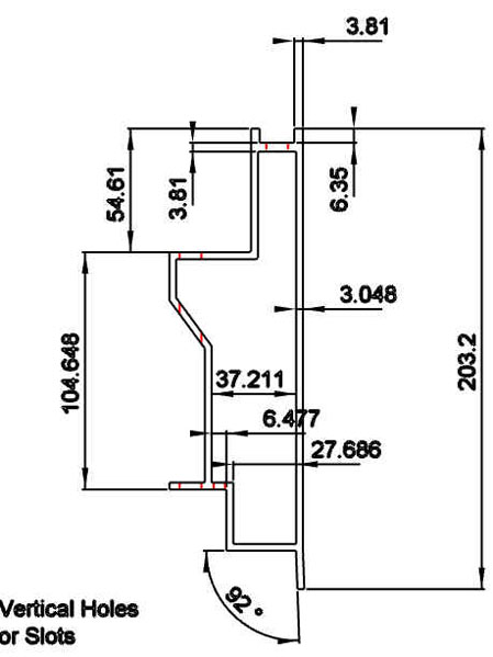

Hi Neville... I'll attach a photo of the end view of this thing. It's a hollow channel, 8 feet long. Along its length, every 25mm or so are holes drilled through (indicated here by the red lines.)
The part is too tall to stand up under the gantry, so it must lay flat and be drilled from the side.
An aggregate, even if my machine will hold it, is pretty much out of the question due to the price. It'd take forever and a day for this job to pay for it.
However, I can get a pneumatic drill and chuck a bit into it, and mount it to the side of the router to drill the holes... ASSUMING that my particular router (CS41) can handle the weight, which shouldn't be more than 5-8 lbs. I haven't seen any information in the manual about the weight capacity of the Z axis. I'd really like to hear Thermwood's opinion on this, they know the structural capacity of the machine, and I sure as heck don't want to exceed it.
