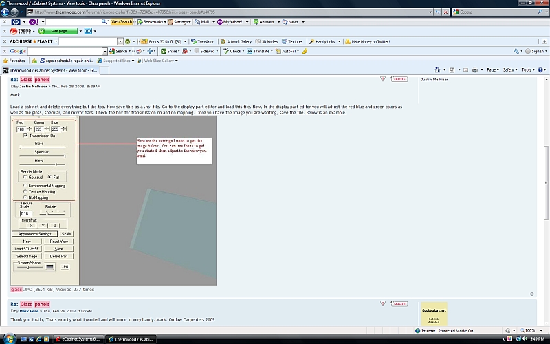

Re: Mirror
Post by Gary Puckett »
Tom,
Try this.

Thanks Gary, it took me a while but I figured it out, did it once before in about V4.2, it all came back to me. It would be nice to have glass as an option in sheet stock though.
