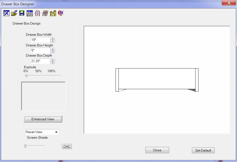

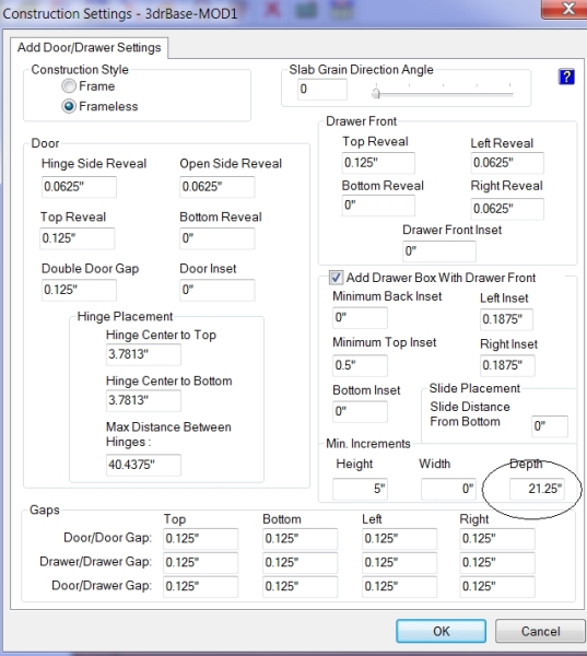

Hi, fearly new at ecab and shopbot link, so far I can do anything I what and loving it.
But I'm trying to setup a base cabinet to follow Blum TandemBox specs.
I tried using a standard box drawer using only a Deck an Back, work find for the width, my problem is when I insert the drawer in a cabinet I have to calculate back inset according to specific track.
I general I used 550mm track so my drawer Deck have to be 526mm and Back 84mm. the height Back height is easy, its my deck that kept changing depth.
Does some one have a ideal how I can built a drawer box that only adjust in width!
thank's Alain
Wally Schneeberger
Posts: 481
Re: How to Build a Blum TandemBox type drawer in ecab!
Post by Wally Schneeberger »
Just design a box the way you want it and then set the length. It will not change.
