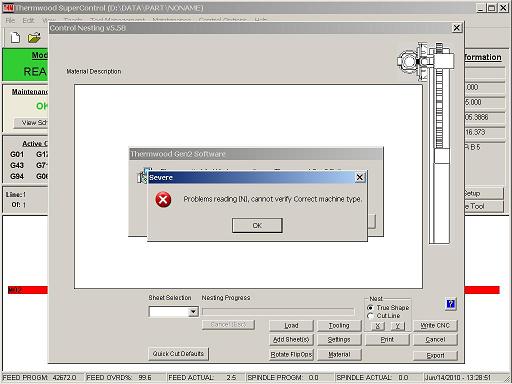

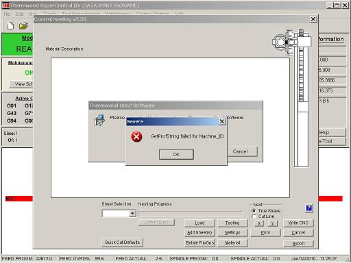

hi all all of a sudden today when i open control nesting i get this message attached
not sure why is this happening can someone look into this oce i click ok it message appears again
afterv two times it closes but sure got some issue in nesting also
pls suggest

I would suggest running the latest control nesting update file that you have and choose the REPAIR option. It seems some files have been corrupt or misplaced on the hard drive of controller.

i have done the repair using the latest update but still it is same, any other way to fix it as it is killing time at nesting
pls advice

we have found the problem which was recently installed the microsoft office on the machine to use execl job sheets and it has over witen the acess 97 which was a older version and replaced with newversion whichb is causing the trouble but any way we have restored it back to previous date and is working fine we have uninstalled the office now
its fixed now up and running fine
