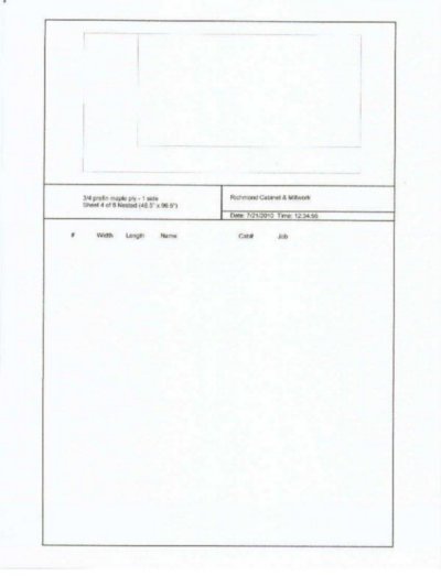

In the pint dialog you can choose to print the selected sheet. When I tried it, the attached is what I got. No parts are shown for the sheet. Perhaps the Thermwood guys can check on this.

thanks for the reply. i just tried it also and recieved the same sheet with no parts printed on it. i hope there is a fix for this.

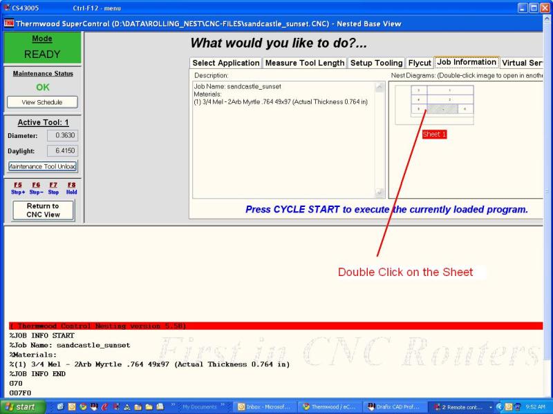

Try writing the CNC file. Then in the upper section where it shows each sheet, double-click on the sheet you want and it should open up in a different window showing the parts and and itemized line listing.
Dave,
I have tested this and can confirm that any selected sheet besides sheet one prints blank. I will let the software engineers know.

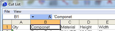

While you're at it, when you export the cut list to Excel, the sheet component worksheet has "Componet" instead of "Component" (note the missing n ) for the column heading.

I am talking about the control. Once the job is nested and you write the CNC file the layouts of each sheet come up at the top of the screen. Double click on the sheet and a new window comes up. You will see the sheet layout and also the line listing of each part. You can print from here.
-John

It looks like you are running a different version of the control software than I am. My screen looks nothing like yours.

John is running with the new QuickCut interface that is available on the recent THM controls.
You can read about it here: http://www.thermwood.com/header/quick_cut_main.htm
