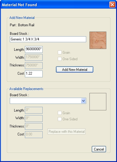

The problem seems to be with one of your materials that was used for the bottom rail on these cabinets.
You have the length set as 9800000" and the width as 1750000" and the thickness as 750000"
This is causing some problems.

Thank you guys:
Finish of the problem. It seems that changing from metric to Inch measurements created this odd dimensions on the material list.
its great to find a SOLUTION
