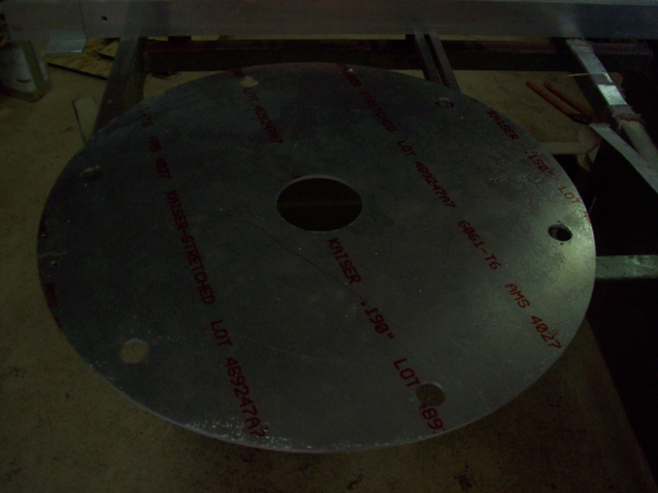

I just wanted to thank Ryan, Brent and everyone else for their suggestions and help. I ended up getting the tool that Brent recommended (Onsrud 63 series o-flute). I didn't cut it one pass like everyone said I could, I was a little conservative. I figured I would post my setup in case anyone else ever needs it.
Onsrud 63 Series O-Flute Upcut bit .25 Dia.
150 ipm. 16000 rpm
.03 depth of cut per pass
Cut like butter. I did squirt a little coolant on in the path every so often.
I could have taken a larger depth of cut, but it was cutting so smooth and I didn't want to take any chances since I only had 3 pieces to cut.
Thanks again,
ZachF
