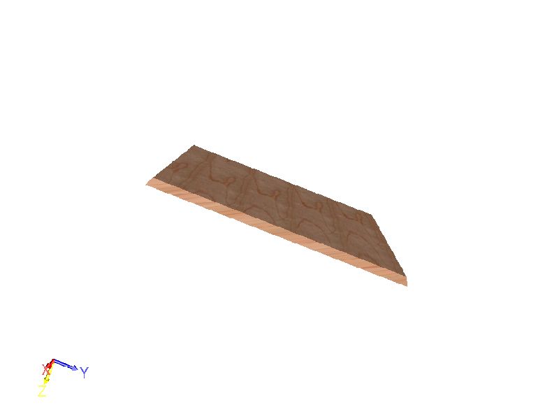

You're wanting to do this right? This is what I did with the tool and settings above.

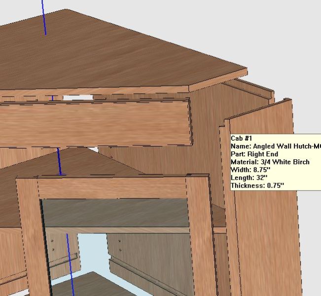

Dan here is the finished product 1st rev anyway. anybody wanna guess on price it is going to be in lyptus ply and pre finished maple ply on interiors. tandem slides, and a whole bunch of rev a shelf stuff. no stain just clear.
Brian

Is it something like this? I did this on all four sides instead of just one like I think you are wanting.
If this is what you want, here is crude the tool I just made to do it.

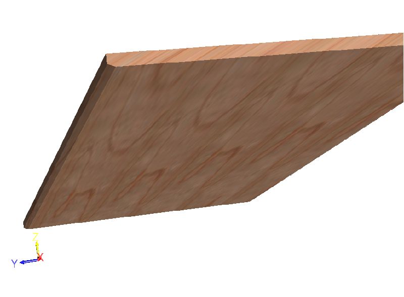

Is the side in the pic below what you're trying to do? I did it by creating the attached unglamorous .tol file in the shape manager. Load it into your "My profile tools" directory under thermwood in your public documents folder. Just set the plunge depth to -.75 in the tool selection menu.
