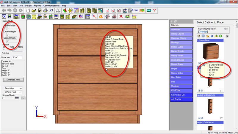

I first noticed that the number of slides for a batch job was incorrect and started experimenting. Here is what I found (notice the cabinet size issue as well):
1. Started with standard framed base.
2. Removed doors, mid rail and mid stile.
3. Set default drawer box.
4. Added 3 drawers with boxes.
5. Added 3 slides to cabinet.
6. Saved with name "3 Drawer Base" (name is not important).
The cabinet correctly shows the size and slide count.

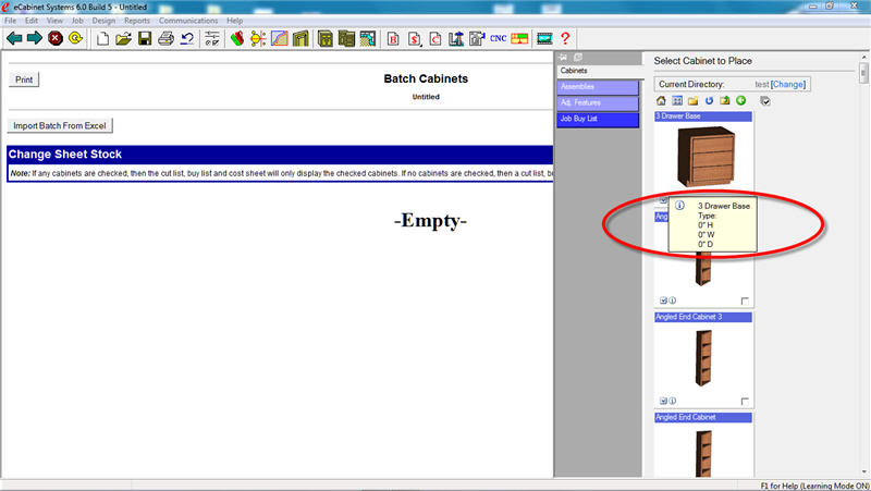

Next steps:
1. Clear workspace.
2. Click Information (i) icon for just saved cabinet.
The size is shown as 0"w, 0"h and 0"d!!!

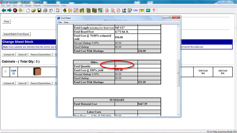

Next steps:
1. Create Cost Sheet.
Slide quantity was 3 instead of 9.
Next Steps:
1. Looked at Buy List for batch.

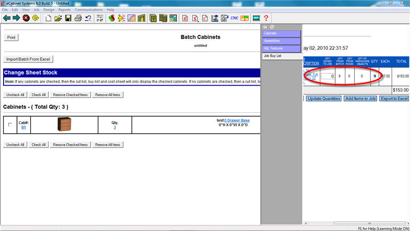

Next steps:
1. Looked at Job Buy List for batch.
Slide quantity was correctly shown as 9.

Selected the cabinet, changed quantity to 3 and added it to the batch. Looked at Buy List and Cost Sheet, both show only 3 slides instead of 9. I get the same result after nesting. It is just showing the slide quantity for a single cabinet, no matter how many are in the batch.
The cabinet does show the correct dimensions this time so that must have come from the other drawer box as Josh suggested.

I see the issue with the drawer slides (FYI: this is an old issue and is not new to or caused by Bld 5). It boils down to "Added" hardware items are not showing the quantities correctly in the old buy list and the cost sheet when multiple quantities of cabs are added to the batch (I was not seeing it earlier because I was adding them on with the drawer fronts before you gave us your steps in your last post). The newer Item Window Cabinet/Job Buy lists will show this correctly. For now, you can set a drawer slide default and have it add to cabinet as each front is added and it will show correctly in all areas. You do not have to set a pattern for the slide unless of course you want to. This may just be my opinion, but that seems like a better way to go, as it will add a slide automatically based on how many drawers you add to the cab (not trying to diminish the issue here, which we will resolve and appreciate you bringing it to our attention). Also, don't forget about the handy Apply to/Clear... icon options that will let you Apply to Cabinet, Clear from Cabinet, Apply to Selected Parts, and Clear from Selected Parts.
Now, the second thing is the 0"h 0"w 0"d issue you were seeing. I cannot reproduce that and am very interested in narrowing that one down if I can. I saved the drawer box from the cabinet you posted here earlier and cannot reproduce the issue using it in a standard base framed as you described at the beginning of the post. Can you still reproduce it with the drawer box you were using at the start of this post?? If so, could you please attach that drawer box file and some steps(if diff from previous steps). Thanks in advance for you help.

Of course I can't reproduce the 0-0-0 issue. I even rebooted yesterday and was able to reproduce it but today it behaves correctly...go figure.
