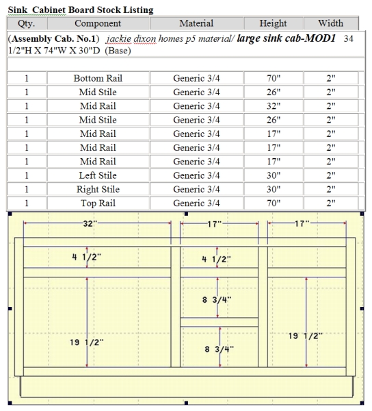

Why not copy and paste what you need into a word document. Kind of like what I have been doing with my cut list and frames.Still time consuming but could be done faster than an hour.
Just a thought.
Damon
