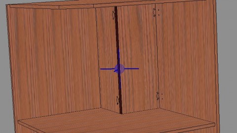

Are you trying to make a corner bi-fold door like this?

yes that is what we r trying to do but instead of the hinge holes on the middle we use piano hinge so no holes on the left door of the picture you sent

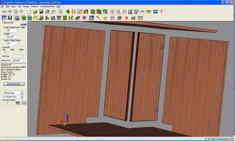

You would be more like this.

thats correct obviously it can be done (Please explain)

Yes it can be done.
In the Door Drawer Front Editor click to select the left or right opening (which ever side you want to hinge from) and place the appropriate door (Left or Right Hinge) with the hole pattern associated to it. Now Select the other side opening and place a left or right hinge door in that opening. After the second door is place click on it to select it and then in the Item Window under the hinge tab use the drop down menu for your hinge hole pattern and select Remove from Selected part. this will remove the hinge holes from the second door.
You of course will have to set your proper reveals to make your piano hinge work.
Don't try to use the Lazy Susan door as you can't associate hinges to that door.
