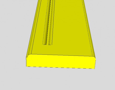

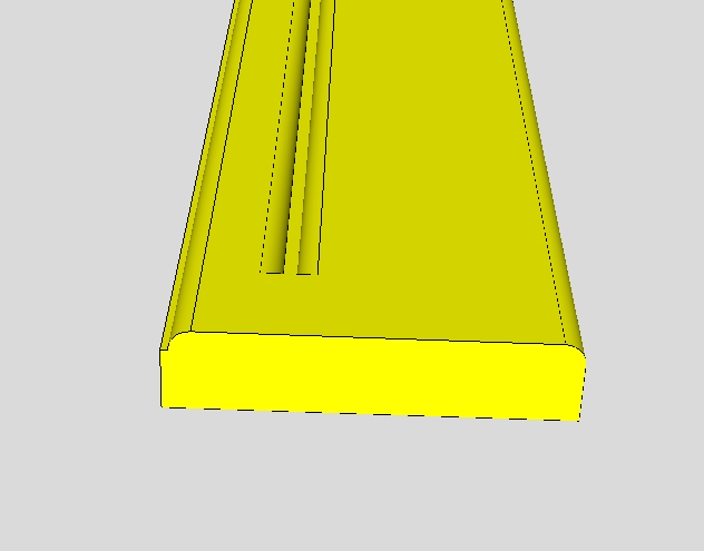

Here is the profile I am trying to produce.

Can someone enlighten me, I managed to do the moulding as shown but in order for it to work I had to start the profile 1/16 in from the edge.Is there a reason II cannot run the profile through as you would with a shaper or router?

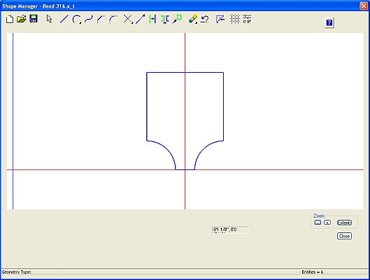

You can post the .x_t file for that tool and I can create the tool from it. You will need to zip the file to post it.

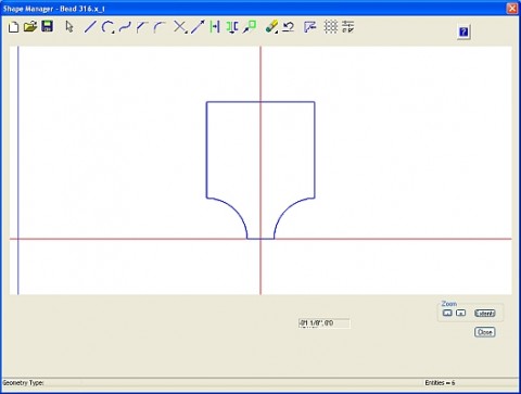

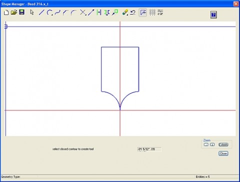

Re: Can't profile part?
Brian,
If you will look at the origin lines (red) in the shape manager they are centered on your tool that has a 1/8" diameter.
Because of this you must "Comp" the tool 1/16" left or right depending on which end of the board you start from or you get the cut on the left of this example.
To get the profile cut like the right of this example without using comp you must create a tool like this with a 0 diameter.
To make your molding I would do a tool that makes all the cuts in one pass to save time.
Brian,
The profile in the middle of the board was done creating a tool path in Contour Mode that stopped short of the board. Your tool follows that tool path on center and does not need compensation.
Your tool without compensation on the edge of the board creates a shoulder as shown on the left side.
You can create any profile to the end of a board.

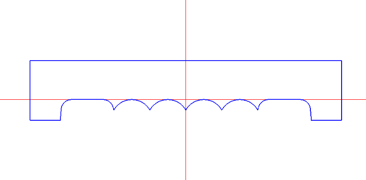

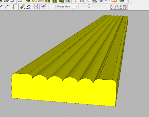

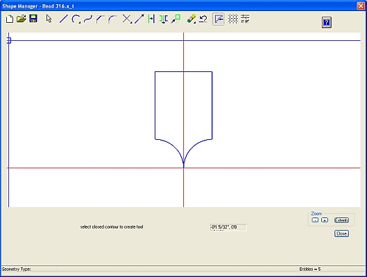

Dennis Englert
Post by Dennis Englert »

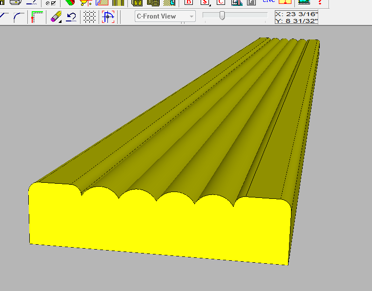

I've created the geometry for a profile similar to what you've shown in a previous illustration. The geometry is drawn similar to what the profile of a molder knife would be. I've drawn the profile at depth, so I don't have to remember what the depth is everytime I would use it. This was created for material that is 3" wide. This could be a Stile or Rail, Display Board, Display Panel or Display Cube.
After the tool is created and in your library, then create a part that is 3" wide by whatever length you need.
Edit the part in the Part Editor. Go to through the "blue" doors into Contour Mode. There you will create a line that is center line of the material. I, also extended the line 1/2" on each end of the board. Probably, not necessary. Return back to the first screen of the Part Editor. Select the tool option. select the line, then select the tool.
The profile is centered on the material, so no offsets are needed.
I've included the geometry and tool files. You will need to rename the files and change the extensions from .txt to .x_t and .tol.
Good Luck,
Dennis
