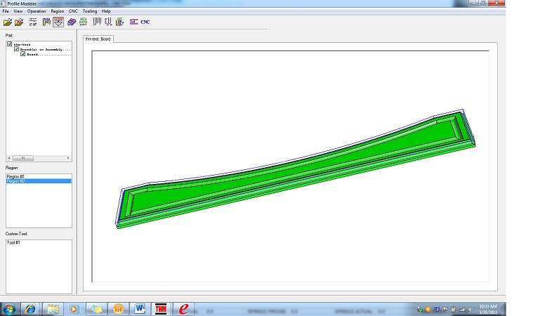

Here is an update to the file you supplied. I took into Part Editor and created a profile cut using the CHAIN option, made sure chain went around entire perimeter of part, then saved and loaded into Profile modeler to verify. I used a general CMT default tool for profile and specified a cut depth.
When you chained perimeter in Part Editor, did the entire outer edge of part highlight green to show chain went completely around?
Profile Modeler screen shot

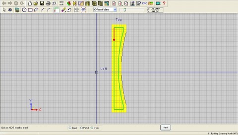

When I select the chain to profile it looks like this
If I take it to the control and verify the path it will only show the vertical line on the left that I started on.

Please find the word doc. attached with some pictures showing the PM screen prior to verification process. Make sure you've addressed the shown settings. I'm seeing a full chain for tool path when verifying your file here.
Thanks!

When I verify the tool path and I zoom in on the part, it should show a red line around the whole profile not just the starting segment?

Yes, you should see the RED, continuous chain in Verify of PM as seen in doc I provided. I will try to find your scenario to see what would keep the tool to one segment of the chain...
