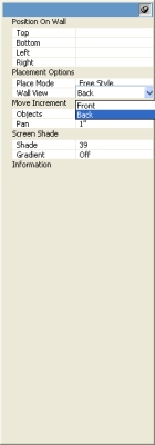

I want to "install" a door on the wall view but the swing is the wrong way.
Can I "swing" in or do I look like a fool when I give the customer the drawing?
Myron

Change from the FRONT view to the BACK of the wall and install it and it will be the proper swing.

Not sure I can find this feature. Where do I look for this?
Re: wall items
Myron,
Take your wall to the elevation view then on the left under Placement Options use the drop down menu next to Wall View and Select Back
