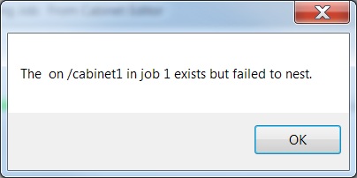

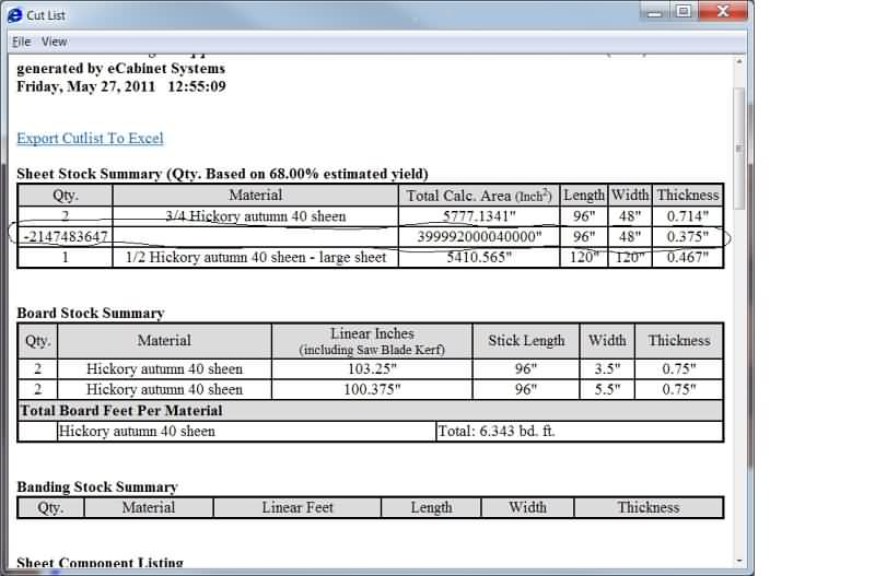

Anyway - here are some weird dialogs I'm getting after I tried to add a stretcher to this cabinet. I've attached the cabinet again to this post. Look at line 2 under the Sheet Stock Summary section of the Cut List dialog. Yikes! The first dialog appears when I try to nest this cabinet.

Donald, I replied to your post in the Suggestion thread, see that response, I was able to fix your cabinet.
