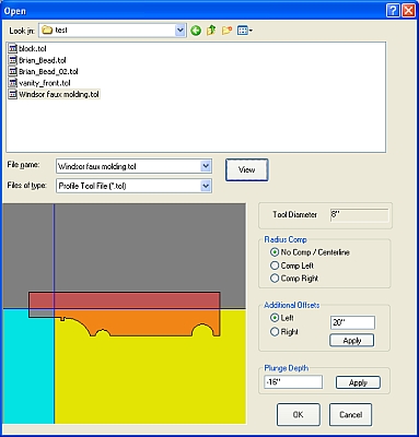

I made a DFX file in AutoCAD. I opened it in the shape manager and chose make a create a tool, selected the shape and chose a diameter (tried a lot of diameters). When I went to use it it did not show up in the list. When I went into Explorer it was in the directory. I restarted eCabs and it didn't help. The file/tool will not show up so I can select it. It looks like a valid file with an appropriate size of file. It is a Windsor Molding cutter.
Can any of you make it work?
Windsor faux molding.tol

Is it in you My Profile Tools directory? Try shutting down eCabinets and Windows and re start.
You have your tool created out in space. I had to use 20" left Additional Offset and a - 16" Plunge depth to get it close to where it should be.
Open your tool in the shape manager and move it to the 0",0" point and save again.

Thanks Kerry, that was it. Wrong directory. And I was able to move the profile so it sat a 0,0. I actually should move it to -1/8,0 because that is how it is meant to cut.
