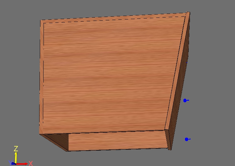

I need to create several cabinets with ends that are angled at 22.5 degrees (See attached sketch showing plan view of cabinets) The cabinets do not have backs, or any stretchers, but will be just be made up of Sides, Top, Fixed Shelf, and Deck, all with RTA assembly. Is there a way to do this in Ecabinets? Thanks

We could probably get the cabinets drawn but I don't think we can get joinery

Since you don't have backs the center cabinet will work great. Still working on the others.

Almost got it

You can build them using corner cabinet which lets you have joinery but you can't add partitions. You can add shelves and soors and drawers.

Kerry, thanks very much for the help. How were you able to angle the ends on the cabinets you've shown?
As a last resort, I realized I could have the corner cabinet 'spread' onto the adjacent wall, and handle all the angles with that one cabinet. The cabinet to the left and right could just be standard cabinets. (See attached screenshot as an example, not drawn to actual size). I'll need to play around a corner cabinet and see what I'm able to do with it.
