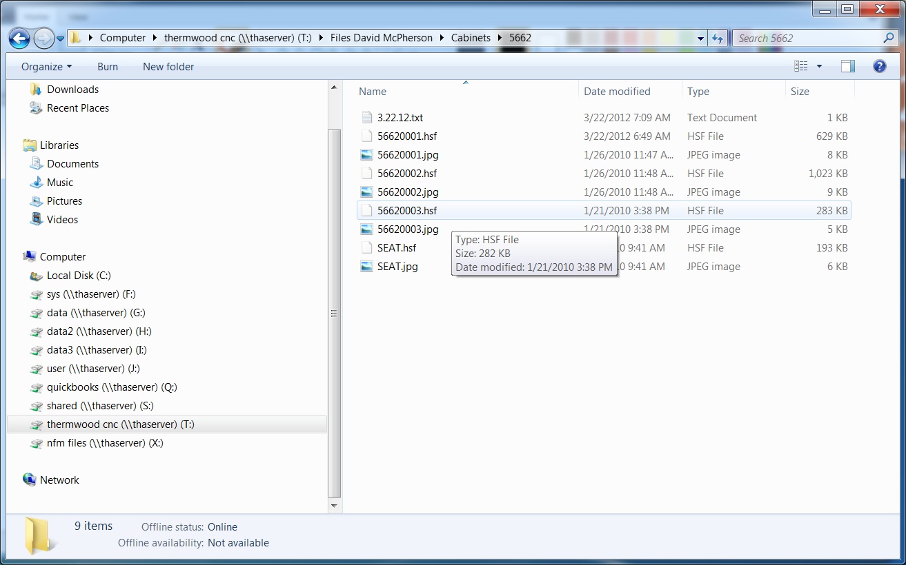

It sounds like the network share permissions are not set correctly.  If you open the network share from Windows Explorer, can you create or copy any type of file to it?  If not, you have permission problems.

I can create and share over the network drive thru windows explorer. Attached is a screen shot, i was able to create a .txt file with in the folder and view/edit. Should i uninstall ecabinets and try to reinstall?

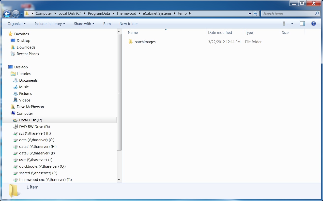

You might want to try going to C:\ProgramData\Thermwood\eCabinet Systems\temp\ directory and deleting any Temp*.tmp files.

i was not able to find any temp files (see attachment screen image)

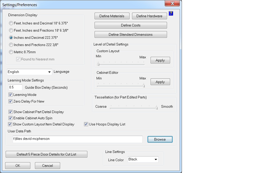

So, your user data path is set to T:\Files David McPherson\?

This is how i orignal set up all the computers on our network. (see path on attachment) We have never had a problem. I hope for all this trouble i just have something checked wrong?
