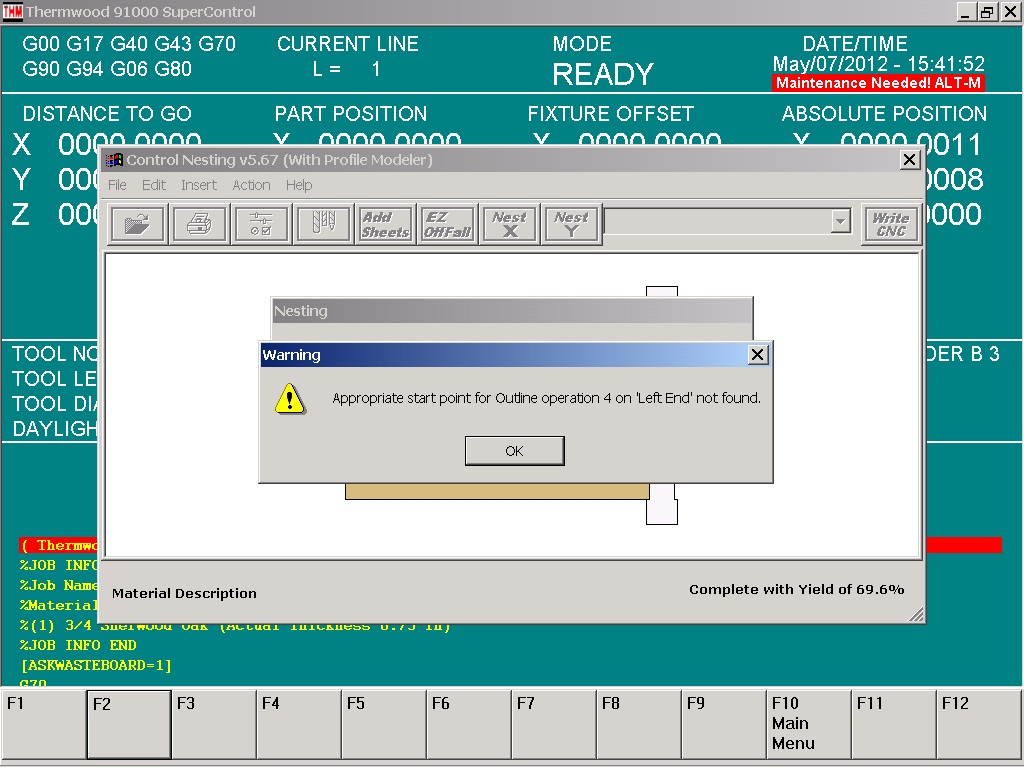

Chris B Campbell wrote:Trying to run a simple box get this warning while nesting in C.N. Did a dry run everything seems fine but...
Any help?? Well I see the bmp extension is not allowed ... Warning states: Appropriate start point for outline operation 4 on "left End" not found.
Chris
Chris,
We will need more info. Please attach or send us an export from CN with the twd loaded that causes the error. Also, send us the job, cab, or assm that you created the twd from.
I cannot reproduce the issue here. You did not get me an actual export, so I do not have your exact settings. I would recommend that you first update to the newest version of Control Nesting and then try it again. If it still gives you the error, then get me an actual export and I will try it here. Thanks in advance.
