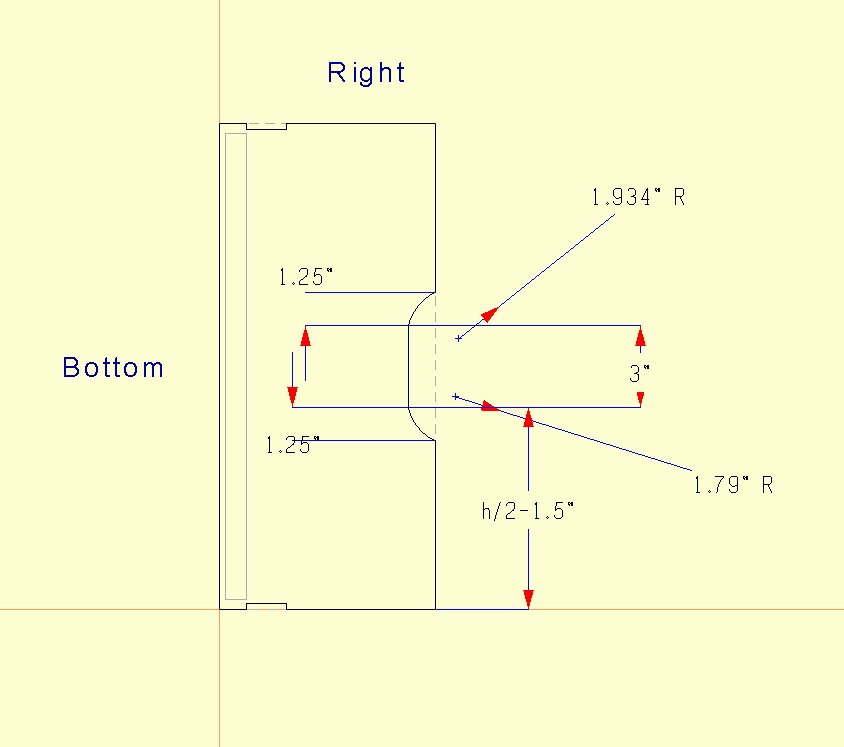

Been trying to make a finger pull cut out in a drawer box front. Used a rectangle and a half circle on either side of it in Partr Editor to make the cut out. When I try to add the drawer box to cabinet I get a message that says "Drawer box cannot be regenerated. Press Yes to remove part editer cuts or No to remove drawer box. Now I have tried this with just the rectangle and same thing. I tried it with a circle cut out, and it will place the drawer box in the cabinet. Oh I am doing this in Drawer Box Designer. It works if I add boxes and then make cut outs. But I have a bunch of different size cabinets I have to do this in with multiple drawers. I don't want to make individual cuts in each drawer. Is there a solution to this? And while here When I did use the circle I could not figure how to force it to stay centered in Constraint Manager.

To keep the finger pull the right size and place with resizing you have to use the Constraint Manager.
