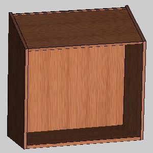

I am trying to make the top of the wall cabinets slope from front to back by 6". I have searched the forum and didn't find an answer. Is this possible? Picture below. Thanks in advance.

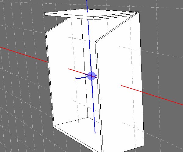

Rob,
Use a stretcher to replace the top. See my example cabinet attached.
