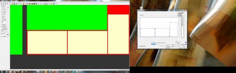

I have a one off cabinet that is nesting single sided material funny. When I nest in e cabs it is doing a flip op on the rafix drill op on the first sheet as other parts are getting system holes, stcc on the "A" face. "A" face is up for the first sheet. Next sheet has only rafix drill ops on two of three parts and the rest is all outline cuts. Since rafix is on the "B" side the rafix are all flips again. Makes sense (though not efficient since all parts could be cut at the same time if the sheet could be flipped).
When I nest the TWD file in the Link I'm getting one of the two flipped parts for rafix drilling, sheet one, as a drill op on the A face. It should be flipped but the link and E-cabs are disagreeing on this. I'm agreeing E-cabs as it is drilling the rafix on the right side. Anyone have this issue between Ecabs nest and Link nests?

TWD file wasn't updated to the changes that were made at the Job level.
