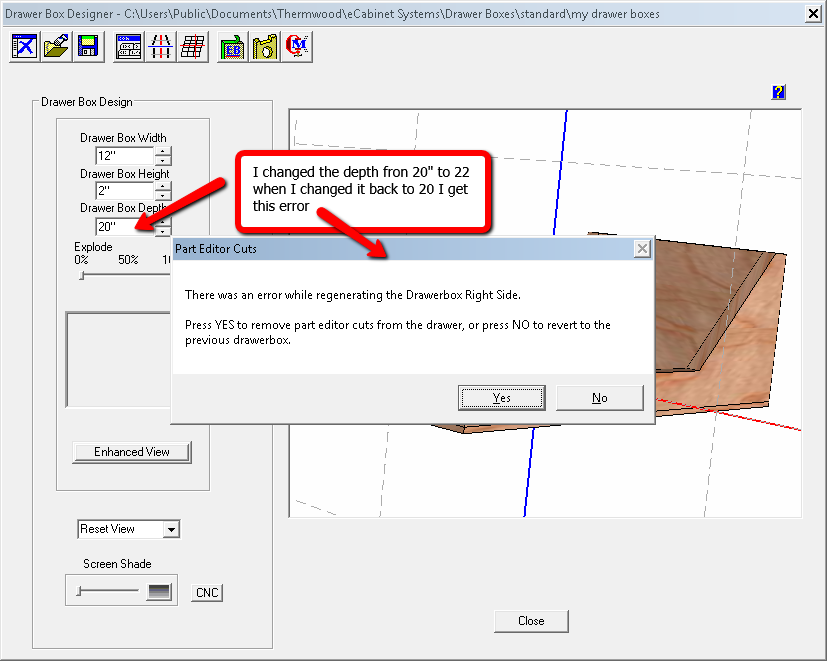

Could some one have a look at this drawer.Somethig seems to go wrong with the constraints in drawer designer when I resize the depth to 22 inches.(The drawer was made from a 20 inch deep drawer) and try to go back to 20 inches I get an error when trying to regenerating part editor cuts. I can resize down as much as I want and go back to 20 inches no problem. I can go from 20 inches to 21 inches then back to 20 no problem.

Rick The drawer resizes fine in cabinet editor. But open it in the drawer box designer and change the Drawer depth to 22 inches it resizes fine but when you try to resize it back to 20 it gets this error

Yes i'm getting the same result. Going up in size, no problem. going down, I get to 21.0625".

Scott,Scott Marshburn wrote:Rick The drawer resizes fine in cabinet editor. But open it in the drawer box designer and change the Drawer depth to 22 inches it resizes fine but when you try to resize it back to 20 it gets this error
I too see the issue with your drawer box. Not sure what the issue is with it at this point. I removed all the PE cuts from the box and re-added them and re-added constraints to it and now my version seems to work without any problems. I will attach my re-made version here for you to use or review. I will also send your original version to our programmers and see if they can come up with any answers for its behavior. Sorry for the inconvenience. If you can come up with any steps that gets it back to the bad state, please let me know.
